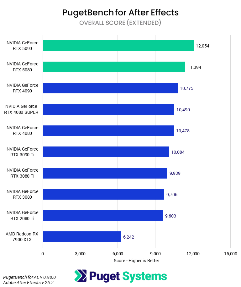

https://www.pugetsystems.com/soluti...e-after-effects/hardware-recommendations/#cpu
